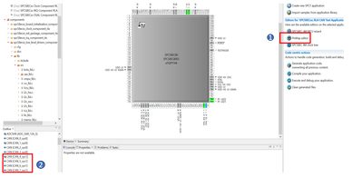

Hi Orbiter,
For what concern to the first question, I suggest you follow the demo in AutoDevKit Studio "SPC58ECxx_RLA CAN Test Application for Discovery" where you can find the example of two different can configurations used for two can bus.

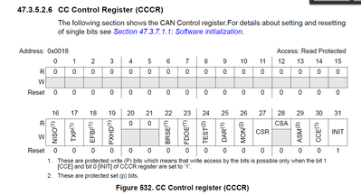

Finally, the following image shows that by default, low-level CAN drivers configure the DAR register to 0.
