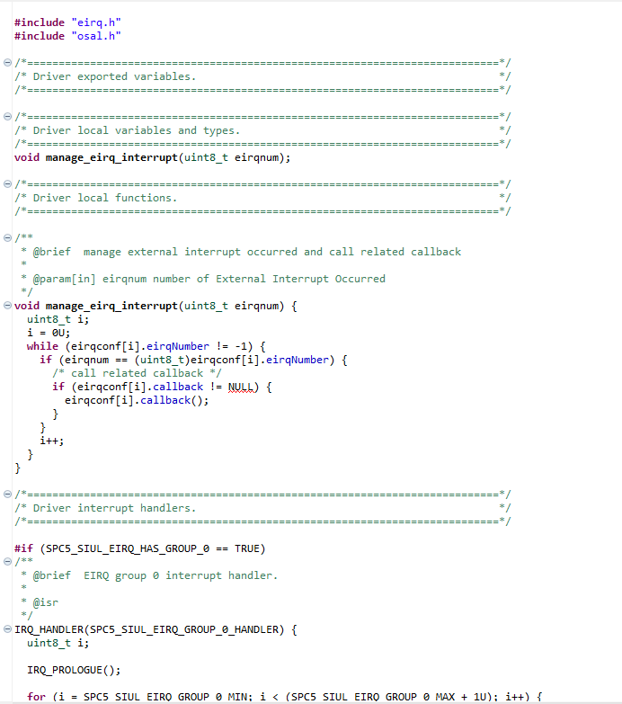

2022-07-05 1:28 AM
is it this one ?
2022-07-05 2:12 AM
yes, this is the code to manage the EIRQ interrupts.
EIRQ can be configured via IRQ graphical configurator:
1) click on IRQ componnt
2) select EIRQ
3) configure which EIRQ to use and which callback to connect to selected EIRQ
4) configure rising/falling edge and enable filtering of glitches
