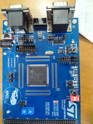

I am using AutoDevKit to develop an application on the SPC563M-DISP. I have a AEK-MCU-SPC5LNK debugger and want to program and debug my software on it. As I know this version only support OpenOCD, but the problem is that I am unable to find the ".cfg" file in the OpenOCD folder, inside the AutoDevKit software.
1. Where Can I find the ".cfg" file for the SPC563?
2. Can I debug and Program the SPC563 using AEK-MCU-SPC5LNK and OpenOCD?
3. Can the AEK-MCU-SPC5LNKU (that uses UDE) program and debug SPC563M-SIP?
I currently have the 'SPC5LNK ' and want to use that for developming my app on SPC56, but If that is not possible I can get the SPC5LNKU (UDE version) also, but wants to make sure that I will work.

All the jumper settings ok??

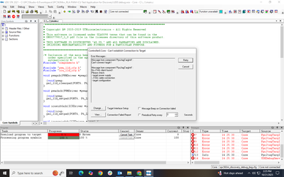

as i have installed UDE starter kit 2021.05
and getting error attached in pic. below

This is an old board I am not familiar with, therefore I am not sure about the jumpers.
On the other side, PLS is trying to access the board and somehow it cannot.
So, two simple points to check:
- Is the board turned on and properly connected?
- are the FTDI drivers properly installed in your Windows? Have you checked if the USB port is recognizing the PLS UDE?
