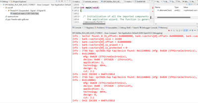

2025-06-25 1:03 AM
Hello Mohit,
I just imported the same demo you mentioned in the post using AutoDevKit 2.6.1.
I cleaned and compiled the project. At this point, I flashed the generated Elf file into the board using OpenOCD without any problems. (see image below)
I suggest removing the project from the Project Explorer, re-importing it from scratch, cleaning and recompiling it, and then flashing the compiled code using OpenOCD.
Thanks,
AutoDevKit Team
