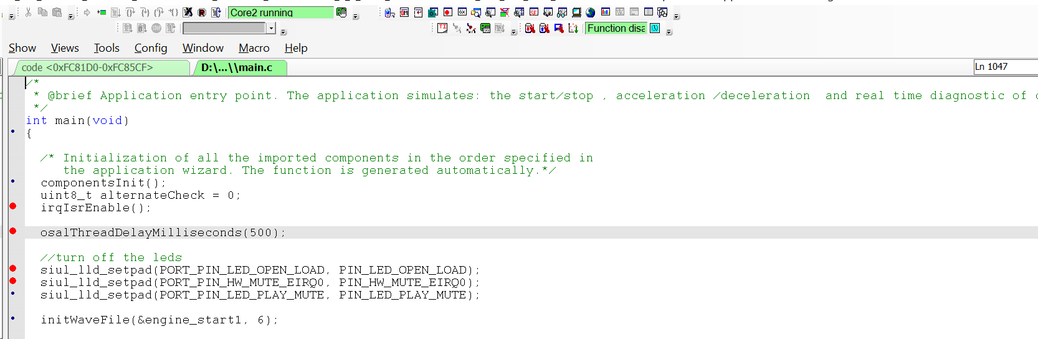

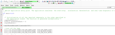

I'm currently working with the AEK-AUD-C1D9031 development board and utilizing the "AVAS Compact 2.0 - Test Application" example code from AutoDevKitStudio2.2.1. I'm seeking assistance in extending this example code with FreeRTOS. However, upon including FreeRTOS_RLA, I'm encountering issues with CAN communication. During debugging, I noticed that the flow gets stuck at osalThreadDelayMilliseconds(500). Could anyone offer guidance on resolving this issue? Any help would be greatly appreciated. Thank you.
Here integrated the freeRTOS into project. | Added Break point. |
4 break points added | It is hitting 1,3,2 break points |
it is hitting osalThreadDelayMilliseconds(500);(2 break point) | heat the program is stopped. |

You are limited to the number of breakpoints with PLS
i recommend to switch in assembler mode and reduce the number of breakpoints.
if you want to use FreeRTOS you should have a main.c like that :
SPC582Bxx_RLA FreeRTOS SERIAL Test Application for Discovery (cf example)
FreeRTOS is using the tick too
