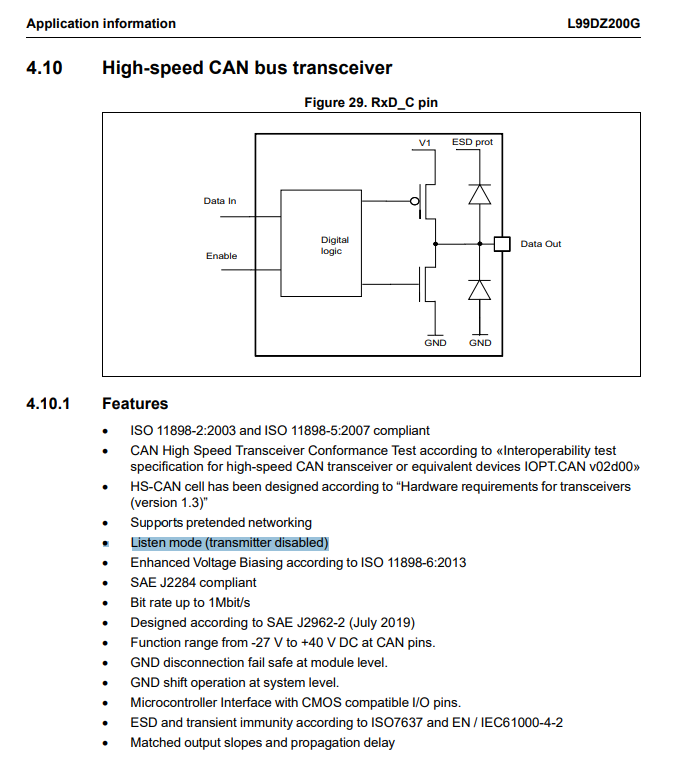

The internal CAN transceiver is Listen mode only with the transmitter disabled.
Refer to attached datasheet paragraph 4.10.1.
2023-11-29 10_09_20-Datasheet - L99DZ200G - Automotive front door device with LIN and CAN providing .png
Therefore you need another external CAN transceiver if you want to carry out a standard CAN bus communication, exactly as you have seen the AEK-MOT-TK200G1 and the AEK-MOT-MR200G1.
