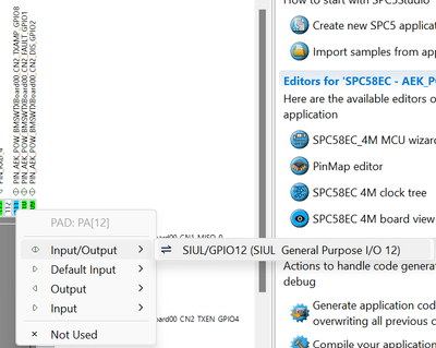

Moreover, I see that the allocation process is allocating some pins as "X".
This means that, somehow, the allocation process allocated an MCU pin not wired to the 4x37 connector.

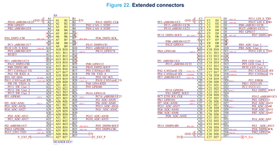

The golden rule to make a system work is that "all the pins displayed on the connection matrix MUST be connected". So BNE and TXAMP have to be allocated manually to an available MCU pin.
To do that you should take a look to the AEK_MCU_C4MLIT1 extended connector, which can be found on the C4MLIT1 User Manual.
The pins you want to allocate are GPIOs, so you should search which MCU pin allocable as GPIO, may be found on the scheme above.

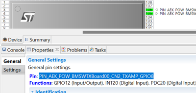

To check which P"x"y" pin may work as GPIO you have to open and take a look to the SIUL section into the Outline window:
I suggest you using pin 111 and pin 87 (which are wired).
Then left click on the pin with "X" and copy the name from the General setting window:
Then right click on the PIN and deallocate it, selecting NOT USED:
Then select the pin 111 and allocate it as input/output
Pasting the name you copied before.
Repeat the procedure also for BNE, then Save all, clean and compile.
Your application should no more have "X" pins allocated

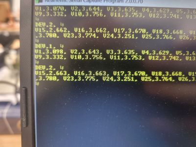

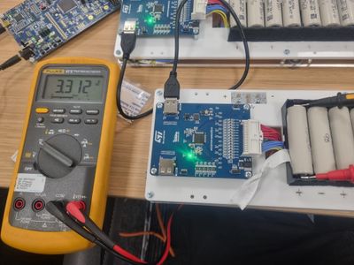

This was really useful, thank you. The "X" has now disappeared and BNE and TXAmp are now allocated to pins. I have also now fully populated each holder with 18650 cells. I think I have it setup how I want, sending voltage measurements from each cell to the serial port.

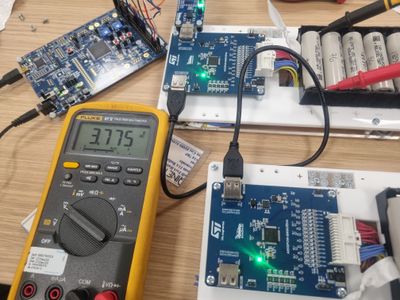

I am however noticing lower than expected readings on some cells. The first two cells on each device (Cell 1 and Cell 15) display a reading around 600 - 700 mV lower than when measured using a multimeter (see figures below), while the rest of the cells are around 100 mV lower. For additional information, the voltage of the cells in the holder ranges between 3.3V and 3.8V for each cell, with a total pack voltage of around 51 V.
Discrepancy in Voltage Values
Fig 1: Voltage readings on terminal
Cell 15
Fig 2: Cell 15 reading on DVM
Cell 1
Figure 3: Cell 1 reading on DVM
2025-02-18 3:57 AM
Hi Luke,
I think your L9963E device is actually missing the ground reference.
Please follow this procedure:
1) Disconnect the BMS holder connector
2) Check both your BMS boards and place each Jumper JP1 in the 1/2 position:
3) Reconnect the BMS holder connector.
This should solve your issue.

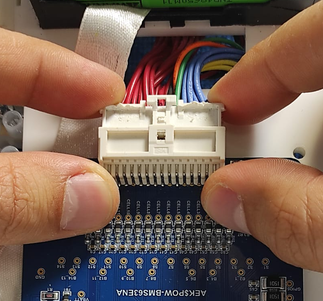

Note: Sometimes, even with the jumpers, this problem happens. That's because the BMS connector is not inserted correctly. Try to reconnect it by pushing along the borders, uniformly, as in the picture:
Best Regards
AEK team
