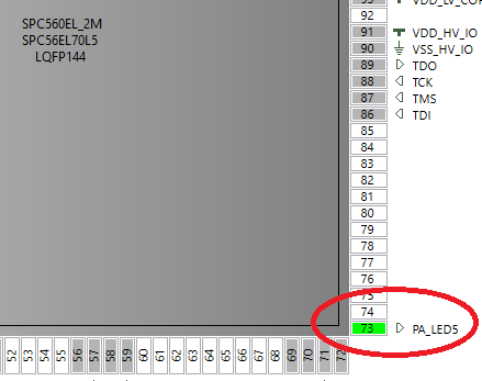

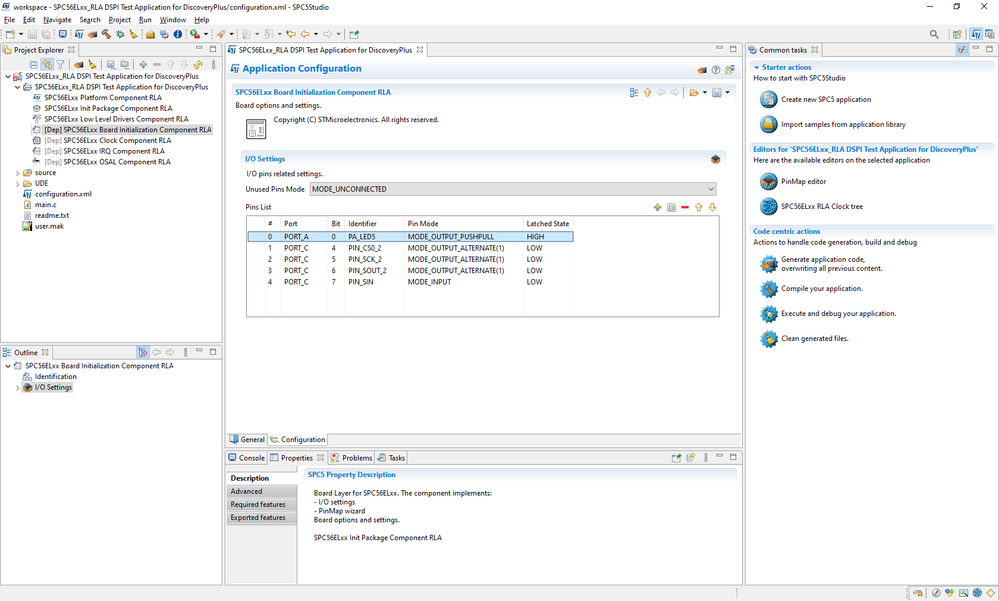

Dear Arash,
in your project :"SPC56ELxx_RLA DSPI Test Application for DiscoveryPlus"
you have a GPIO configured in OUPTUT to blink a LED:
_legacyfs_online_stmicro_images_0693W00000dDT4iQAG.pngit can be easily configured using the pinmap editor:
_legacyfs_online_stmicro_images_0693W00000dDT5HQAW.pngthen in your main function you have the code to call gpio driver to blink the LED:
