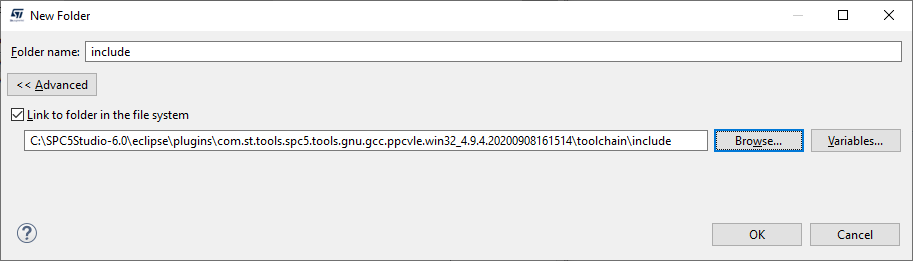

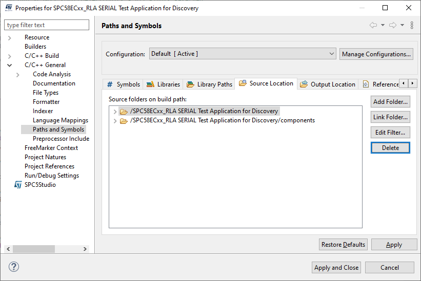

to resolve includes in SPC5Studio,
right click on your project and select properties:
_legacyfs_online_stmicro_images_0693W00000bVhaCQAS.pnggo in menu C/C++ General->Paths and Symbols,
Source Location, click on Link Folder:
_legacyfs_online_stmicro_images_0693W00000bVhbPQAS.pngselect your needed include folder and click "OK", then click "apply and close"
-Best regards,

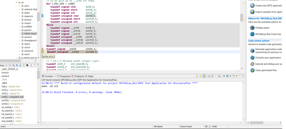

Thank you for your guidance. That problem was solved, in addition I let that "C/C++ indexer " to be 100%.after that this problem about "syntax error" is appeared :
_legacyfs_online_stmicro_images_0693W00000bVjYrQAK.pngHow I could solve it too!?))

Perhaps use stdint.h that comes with the compiler (GNU/GCC ?), and not use the MSVC (Microsoft Visual C) one?
Or create typedef's using intrinsic types from the compiler? What are the 64-bit types in the compiler / toolchain ?

Dear Customer,
Tesla DeLorean is probably right.
You probably included as link a folder that is for windows, and not for gcc.
You can see that your compilation is withour errors nor warnings.
this means your makefile/toolchain is based on right include
But the eclipse C/C++ analyzer (which provides the syntax error) is based on the folder you linked, it should not be the good one.
You have to remove this one and add the good one.
Best regards,
-Olivier (Just call me Oliver ;-))

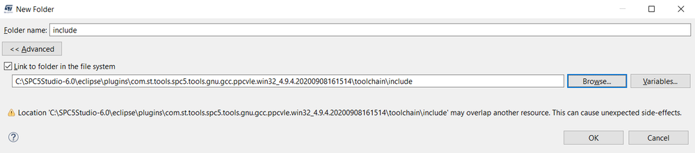

A.Kalv.1
Associate II
Hello Oliver,
I add this folder and it seems it works correctly!.. ;)
_legacyfs_online_stmicro_images_0693W00000dDN8AQAW.png But I do not know why HIGHTEC does not answer emails!
