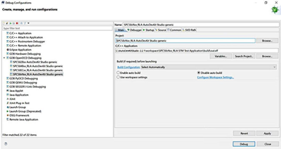

Select Debug Configurations.
After selecting your configuration, insert the path of the elf file in the project field. Click on Debug.

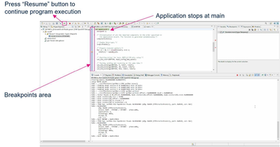

The console opens up and shows your application code execution. The code execution stops at the main file. To continue executing the code, press resume. You can manually insert a breakpoint to stop code execution.
