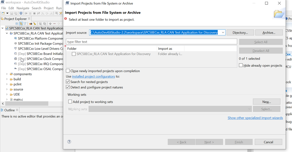

Attached you can find the CAN RLA example to be imported.
Unzip it and put it in a working folder or AutoDevKit workspace folder.
Go to File>Open projects from File System
Generate and compile the code.
I have also attached a PDF document with basic explanation on CAN usage.
