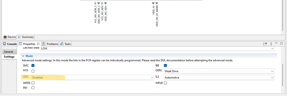

Measuring the voltage on the testpin it looks like my MCU is sinking the complete voltage, no matter if the button is pressed or not.
How do i configure the GPIO in a way that I could read from it without it to sink all the current?
And where do I find this SIUL Documentation I should read before dealing with the advanced settings?

Kindly check whether you disabled the OCD driver in the appropriate pin.

2023-11-15 1:09 AM
OMG!
How is one supposed to find that? Well hidden.
But thanks, it solves the problem.
Do you know where I can find information about all of these settings? The ODC options need some clarification, as well as the other options. More than the one sentence tooltip explanation?
