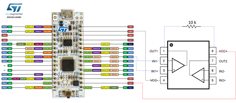

In the attached picture, the schematic is shown where PA4 and PA5 are the DAC outputs which are input to the IN- & IN+ inputs of the comparator. Normally when IN- becomes >= IN+ the output should become LOW, however in my case the output is always HIGH unless IN- becomes =Vcc+.
P.S: The 10k resistor is a pull-up resistor and it is needed since the output of this comparator is open-drain.
2020-11-26 6:52 AM
If complex setups fail. try simple things first. Make a chain of 3 same resistors about 10k or so connected between GND and VCC. Connect the the lowe of the two divided voltages to IN+ and the upper to IN-. Output should go low . Swap and output should go high. If not, TS332 is broken or some other part. If it works, measure the IN +/- voltages in your complex setup. Probably IN+ is also nead VCC.
2020-11-26 8:43 AM
Thank you for the proposal.
i actually also tried a simpler setup where I used a voltage supply directly for IN+ & IN- which yielded the same result.
I will try pulling up IN+ and keep you informed.
