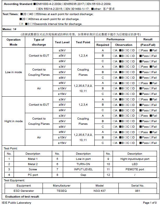

TDA7851L can pass the ESD test of ±3KV contact to EUT without any pop nosie or muting?
My a product using TDA7851L have POP nosie or muting when do ±3KV contacting ESD test 。But my costomer requests that there be no noise or muting . I have bought a lot of products in the market that use TDA7851L for testing. These products will be muting.So I am not sure whether there is something wrong with my design or the TDA7851L itself cannot pass.
