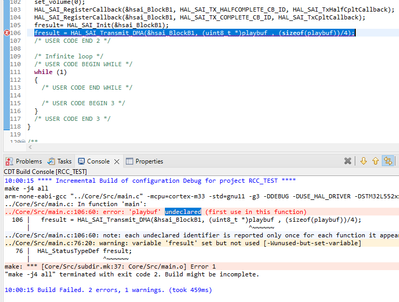

Yes now it's better but How did you declare playbuf please ? An array ?
2023-07-25 1:11 AM
i wrote down in my post...you didnt read, eh ?
int32_t playbuf[4096*2] __attribute__ ((aligned (32)));

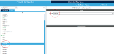

Sorry I didn't read all your message. How to switch off d-cache ? By software or by configuration CubeMX ?
2023-07-25 1:23 AM
your cpu has d-cache ? then ...as you like.
if in Cube ...de-select.
or in main.c just comment out.
2023-07-25 1:32 AM
I can't see d-cache in CubeMX but icache probably it's the same ?
if so then it is disabled
2023-07-25 1:38 AM
no !
i-cache is Instruction , for code
d-cache is for Data !
I-cache is no problem, leave it on.
2023-07-25 1:58 AM
@AScha.3 wrote:no !
Sorry but I can't find where is the 'DCACHE' tab under CubeMX, can you show me ?
