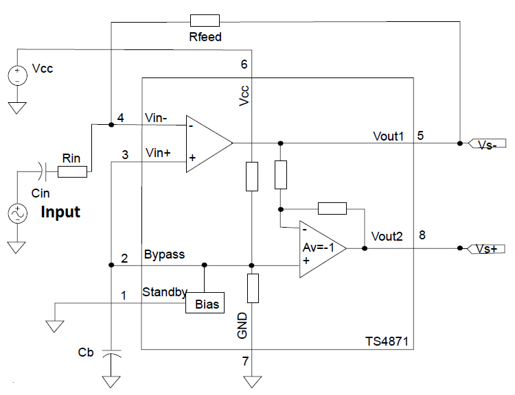

On a existing Electronic board, the following schematic is implemented:
May I use it in single end mode with a serial capacitor between VS+ (or VS-) and the load connected to GND?
May the other output VS- (or VS+) stay unconnected?
What is the bias voltage on the output VS- or VS+? (VDD/2?)
Thanks.
