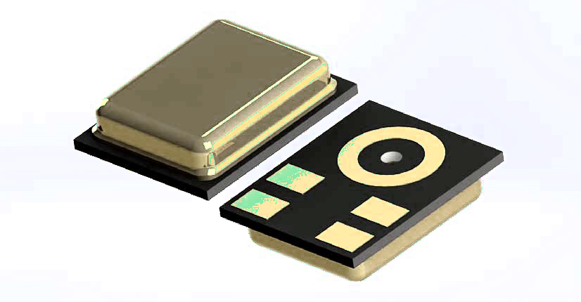

It looks like you don't need a mic for ultrasound.
If the replacement should also be analog, ST has exactly one alternative, but not with the port on top, but at the bottom side: MP23ABS1
There are a few options more if you'd be able to use mic with digital output, e.g. the IMP34DF05, which is included in the the 10 years product longevity program.
