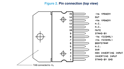

You asked the same question in the music-electronics-forum. The thread there already mentioned possible problems with the power supply - did you check it thoroughly before installing the replacement, i.e. the voltages on pins 7, 13 and 8, 15, as Jazz P Bass suggested?

>are there several versions of the TDA7294 with other supply voltages?
No.
Just H or V (vertical mounting, see ds.)
>input voltage and it is correct 26 volts
?? chip has +/- supply, so check it, before putting in the next victim.
>There is no insulation between the circuit and the heat sink
Check, if there is any connection heat sink to circuit or gnd ! Tab is on -Vs , neg. supply !
