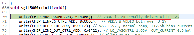

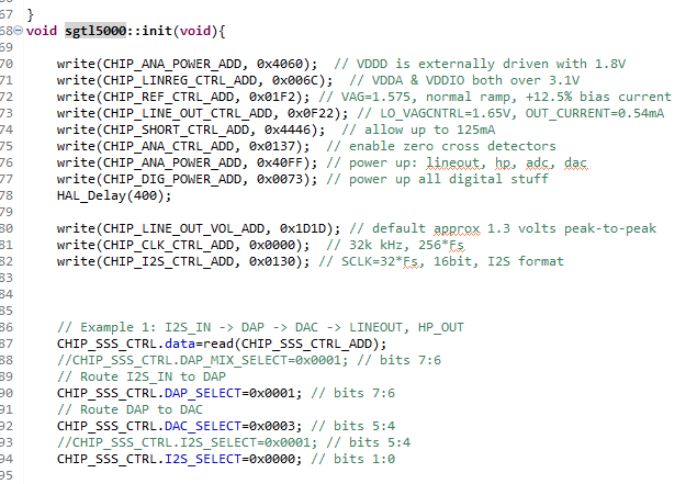

Now I declared a variable of class SGTL500
And when I want to initialize with the method (void sgtl5000 :: init(void))
I call it that way
audio.init();

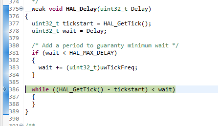

But after I'm stuck at this feature :
I feel like I'm stuck at this function but I don't know what it's for. Do you have any idea where my problem comes from ?
