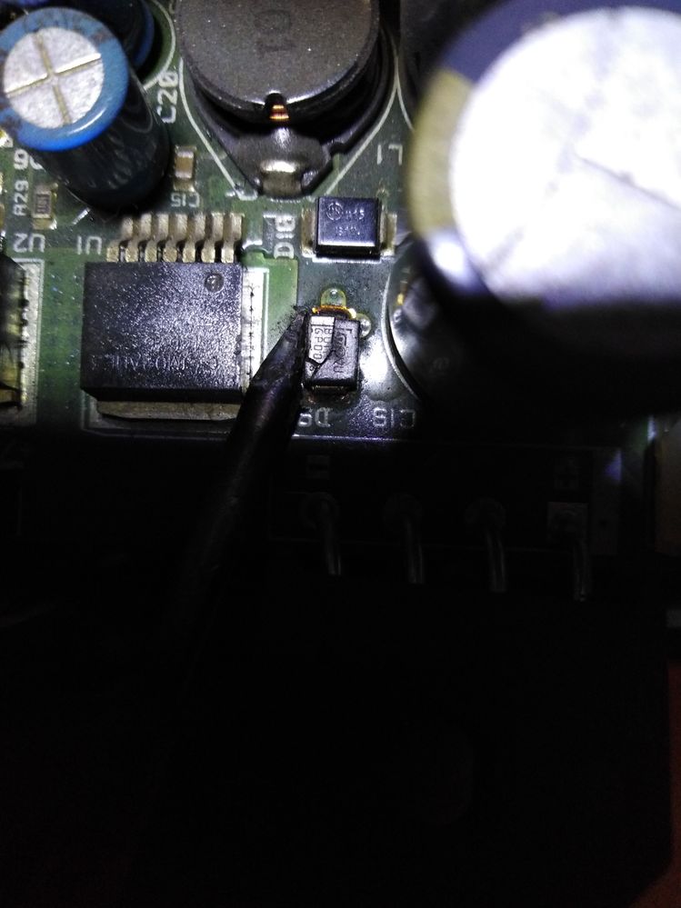

Diode ST ………..

It will be something like this
https://uk.rs-online.com/web/p/rectifier-diodes-schottky-diodes/1513127/
Any 50V 3Amp or greater Schottky diode should work so see what your local supplier stocks.
Bigger question is why did the existing one blow up.

What is the number on the IC U1 ? That will probably give a link to the datasheet and what diode to use.
2020-01-20 8:29 AM
Good day Mr, the uc1 is LM 2676. Thanchk
2020-01-20 8:42 AM
