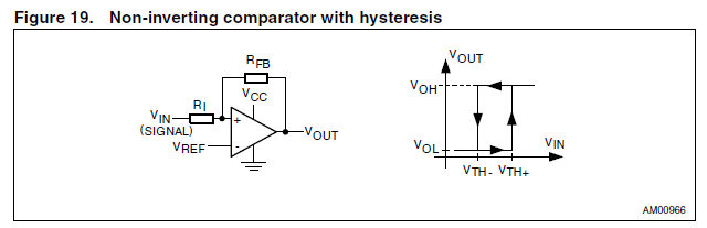

Hi Jean,
The internal hysteresis is useful in order to suppress undesired output toggling. Moreover, it doesn't impact significantly the resolution of the comparator. If the device doesn't include built-in hysteresis, or if a large hysteresis is required, a positive feedback network can be implemented as the following figure shows.We’re moving the ST Community to a new platform to give you a better and more reliable community experience.
