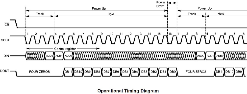

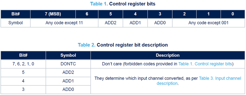

The ADC120 uses SPI for communication.
Please have a look at the datasheet, where you will find the control register on pg. 2, which selects the input channel.
The corresponding timing diagram can be found on page 7:
Good luck!
