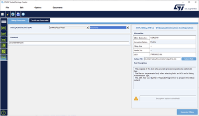

the STM32TrustedPackageCreator supports the obk-file-generation via CLI:
STM32TrustedPackageCreator_CLI.exe -obk C:\OBKey.xml
This requires a xml-file. The gui-version allows the generation directly from a password. Is this also possible via CLI?

2025-09-17 2:17 AM
Hello Amine,
I read the documentation for the CLI tool. As you mentioned, there is only this one option regarding the obk-file.
However, in the gui-tool, there exists the possibility to enter the password and get the obk-file without the need for an xml-file.
I was hoping that there is another CLI-option to avoid the xml-file. Something like this:
STM32TrustedPackageCreator_CLI.exe -obk-from-pwd "0123456789012345"Best regards,
Peter
