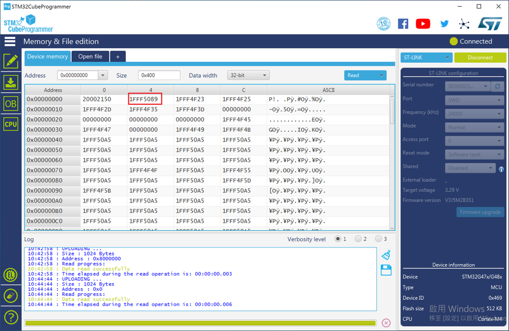

I read the contents of 0x00000000 with BFB2=1. It seems the mcu will start from bootloader. Which is like AN2606 says, system bootloader will help to check bank2 then do bank swap. . Is it really possible to check if system boot from bank2 with cube programmer? cube programmer will halt the mcu on connection

I've found that we can actually run mcu in the "CPU" tab in stm32cubeprogrammer
But bootloader doesn't re-map neither BANK1 nor BANK2 to 0x00000000

Oh I've found we can actually run mcu, simple go to "CPU Tab" in cube programmer and press run.
But after bootloader jumps to 0x08000000, 0x00000000 still remains bootloader's vector table
