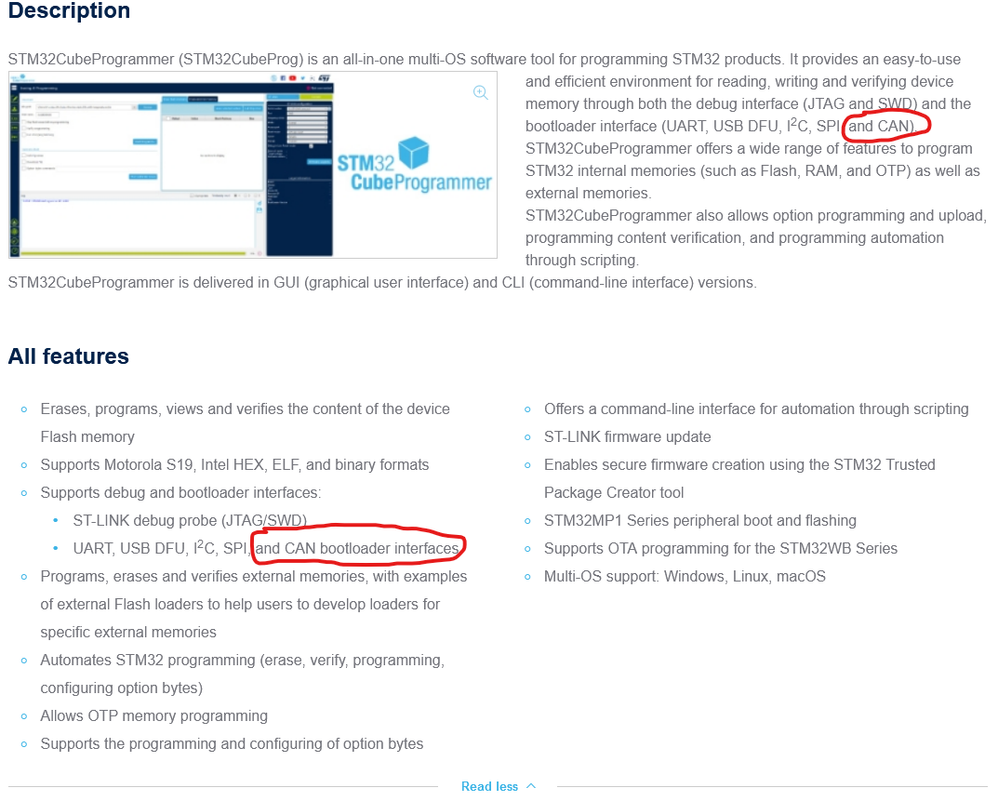

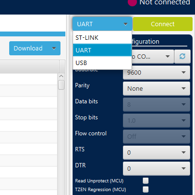

In the introduce page of STM32CubeProgrammer, it descrips that this software support CAN bootloader interface, but I just find the ST-link Uart and USB. How can I configure it to CAN?

Many thank,In user manual, it shows the CAN shall be configured in ST-Link configuration pannel, But only JTAG and SWD selection in Port, it really confuse me~ As to you said, it required a adapater board & ST-Link could the trigger the CAN selection?
