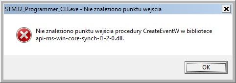

When I'm trying debug my projest I see in console:
Waiting for debugger connection...
Encountered Error when opening C:\ST\STM32CubeIDE_1.12.1\STM32CubeIDE\plugins\com.st.stm32cube.ide.mcu.externaltools.cubeprogrammer.win32_2.1.201.202404072231\tools\bin\STM32_Programmer_CLI.exe
Error in STM32CubeProgrammer
Shutting down...
I checked file location, it is OK, but when I'm trying to start STM32_Programmer_CLI.exe I see dialog
as below:
Translated to english: "Can not find entry point in procedure CreateEventW in library api-ms-win-core-synch-l1-2-0.dll".
My CubeIDE version is:
STM32CubeIDE
Version: 1.15.1
Build: 21094_20240412_1041 (UTC)
OS is: Win7 SP1 64bit
What can I do to fix this problem?
I see that I have another version of STM32_Programmer in path C:\ST\STM32CubeIDE_1.12.1\STM32CubeIDE\plugins\com.st.stm32cube.ide.mcu.externaltools.cubeprogrammer.win32_2.1.100.202311100844\tools\bin\STM32_Programmer_CLI.exe
and this one works fine, no errors. How to force Cube to use this one from "...100.202311100844\tools\..." instead of "...202404072231\tools\..."?
1 REPLY 1
DanielF
Associate
I found workaround: I copied STM32_Programmer_CLI.exe and some dlls from "...100.202311100844\tools\..." to "...202404072231\tools\..." (overwriting wrong programmer), and now is working. But it is not solution.
