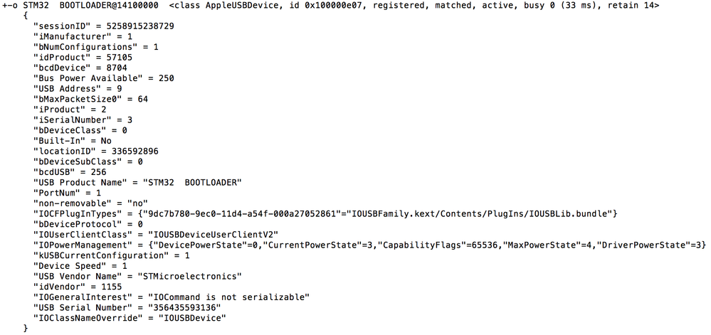

I would be able to help with testing, but that coding is beyond me. Running
ioreg -p IOUSB -w0 -l
in the terminal yields this screenshot.
Cube Programmer reports serial number 356435593136, so that at least matches. When I click connect I get ''Corrupted Data base'', ''Error: Device not supported'', and ''Warning: unknown or unsupported device''.
Perhaps it is a driver issue like on the Windows side.
