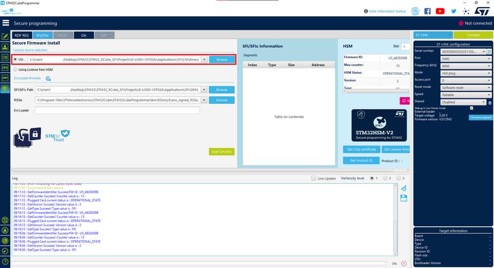

The thing is, when I do it through the interface, I select the HSM license I want to use:
The question is: What would be the command/script to use the HSM license that I have generated (../Binary/MyLicense.bin)

Hello mikel-m,
The SFI command line options are listed in the STM32CubeProgrammer software description - User manual (Rev 25) at chapter 3.2.18 Secure programming SFI specific commands.
In your case, if you want to use a license previously generated from the HSM, this is the part that will interest you:
In your command, simply omit the "hsm=1" option and substitute "slot=1" with your license path.
Best regards,
2024-07-04 7:23 AM
Hello mikel-m,
