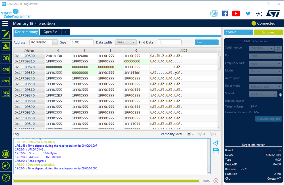

  5. I use STM32CubeProgrammer, to see memory, the bootloader version is located 0x1FF1E7FE, it was D2, (13.2)
I am having a so much headache.
