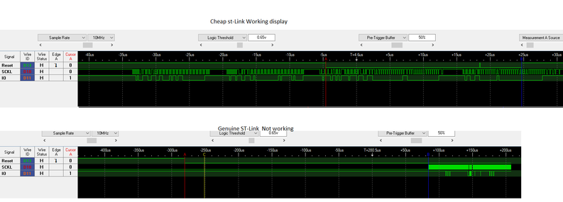

I am having issues with programming a target board with a genuine ST-Link board (got from Farnell) . I have been using a cheap programmer that works, and as I have upgraded to the new IDE (from atollic) it fails to work , but still works on the STM32CubeProgrammer. The genuine ST-Link communicates with the PC, but cant connect to the Cube Programmer, while the cheap one works perfect. I have set the ST-Link Configuration to the below.I also have the images from the logic analyser during a connect sequence. As this is on the same target board and the cheap one work, I think this points to an issue with the genuine programmer. I managed to get a loan of another genuine one, and that too has the same effect. A noticeable difference the serial clock starts before the Reset line goes low , unlike the genuine no clock till a good while after the reset line , and I assume it times out before this. Anyone any idea, I am totally baffled. I checked all the voltages on the board and are correct. The cheap one works on software reset as well as hardware.

Our target MCU is a STM32L433 , and is genuine from a distributor. CubeProgrammer is version 2.14.
Regarding the IDE, I meant I upgraded to the latest CubeIDE from atollic because the new cubeMX doesnt export the project correctly in atollic. The IDE doesnt work with either the new and cheap programmer. I got as far as the CubeProgrammer working with the cheap programmer, and stuck at this. I dont understand why there is so much of a difference in the analyser output with both of them (as above).

We have an appropriate header, and long jumper wires. Actually, the cheap programmer lead is longer than the genuine. I have tried the lower speed too. Anyone know why the difference in the analyser output? Looks like we get a not found due to the time the programmer sends out a clock pulse compared to the cheap one

Also understand that the data pin is bidirectional, so you're not just looking at the signal sent by the ST-LINK, but the response of the MCU. Now obviously if the MCU doesn't respond in the manner anticipated the link is going to fail.
Drop the speed. Perhaps look at what pull-up / down you have going on with your board vs SWCLK / SWDIO

I dont have any pullup/down on the SWCLK/SWDIO, just tried 10k on both, no difference. I would expect this to happen to the cheap one, not genuine
