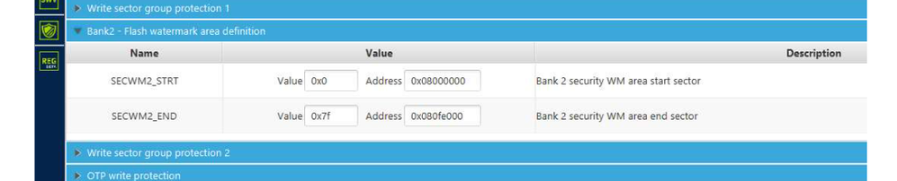

_legacyfs_online_stmicro_images_0693W00000bl7YvQAI.pngas per your configuration it look like your both bank is configured as secure. Kindly update
SECWM2_START value = 0x01
SECWM2_END value = 0x00
apply and save and try to debug.
SECWM2_START value > SECWM2_END value required to configure bank2 as non-secure.

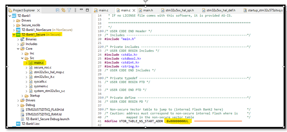

_legacyfs_online_stmicro_images_0693W00000bl7aSQAQ.pngCheck your jump address in secure firmware. it should be start of your bank2 address

@vijay_03​ Thanks a lot for your elaborate clarification. Really appreciate that! I have changed the values as you suggested and it works perfectly. Again thanks a lot!
