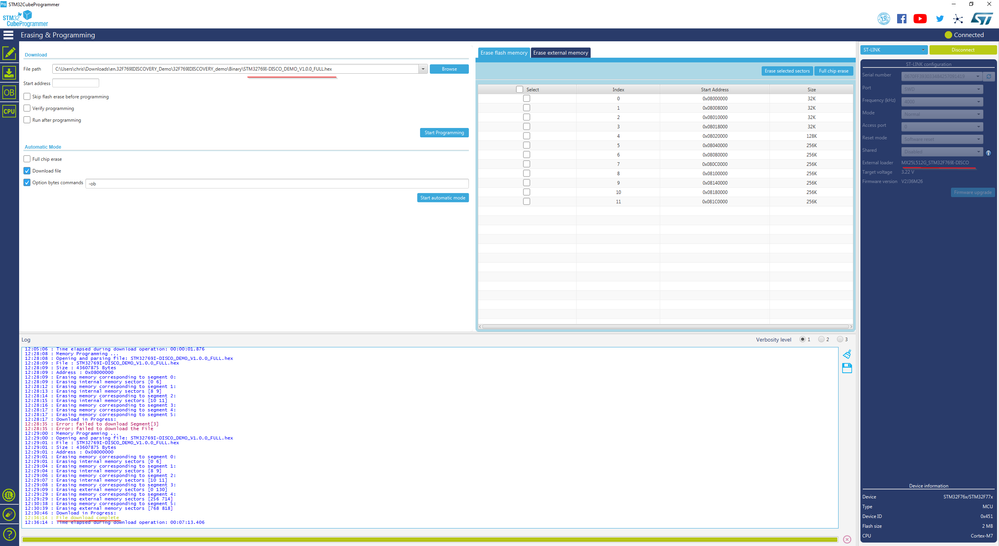

I've upgraded st-link using the upgrade utility. Within STM32 Cube programmer, I've selected the appropriate External Loader for my disco board. My board is connected via st-link and is recognised by cube programmer.
On the erasing and Programming tab I've selected the correct .HEX file and the device begins to program. The file is about 120MB and so takes a good while to program.

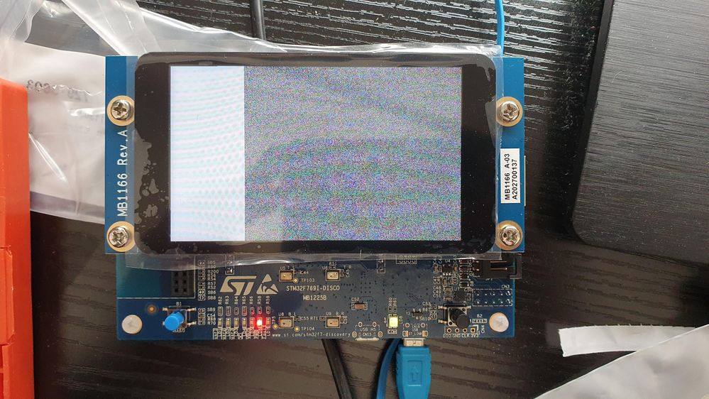

Once the programming has complete, cube programmer tells me that it was successful. However the screen is corrupted, as per the image.
Any suggestions with this would be great, it's probably something that I'm doing wrong

The boards have imagery stored in QSPI, as I recall, so the External Loader needs to selected and functional.
Hi Clive, I've selected the correct external loader in the cube programmer. I've highlighted in the image where it states which external loader ​is selected. Any further ideas that I can attempt? Seems like a strange error that I'm getting.
