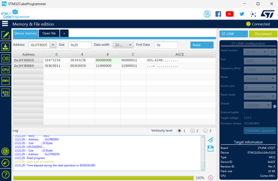

No script needed, just enter the "UID_BASE" address (here: 1FF80050, see the corresponding device / sub-family specific *.h file) and read a few bytes.
There's also further MCU info in the bottom right corner of the window.
