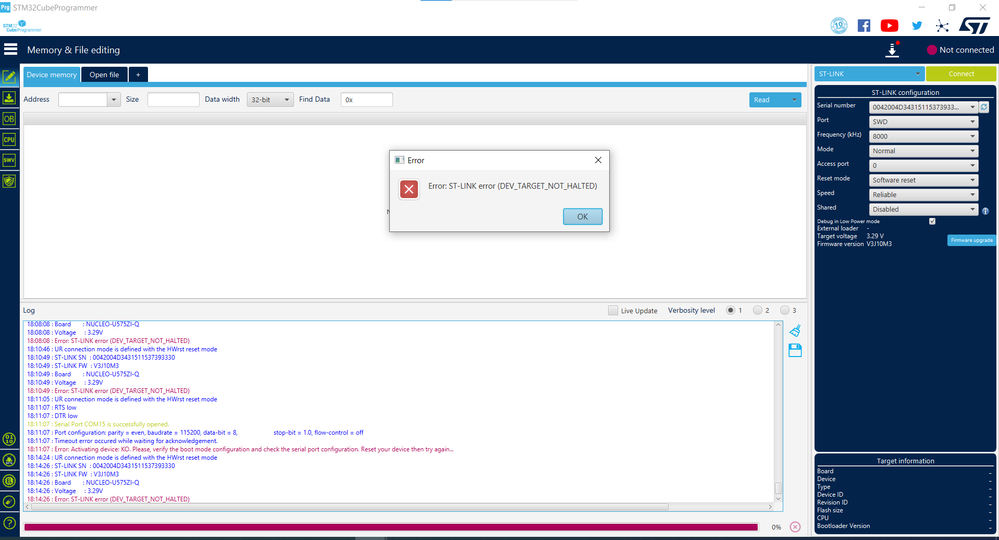

I was trying to disable trust zone in my board.
For that I have followed below step in stm32cubeProgrammer.
Open option byte and set RDP level to 1 and apply and power reset and then RDP 0 along with trust zone uncheck (0).
After that I am not able to connect with my board via stmCubeProgrammer.
It shows below error. I also tried with hardware reset configuration.
Guide me to resolve issue.

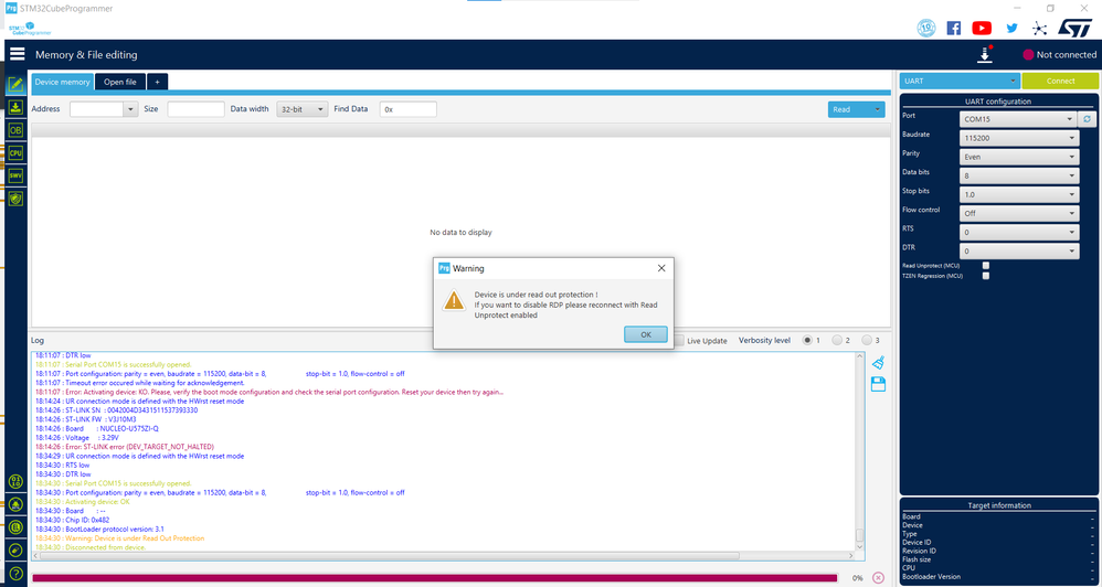

Also tried with UART mode, In that case I received below error.
_legacyfs_online_stmicro_images_0693W00000bj2WHQAY.pngHow to disable RDP?
