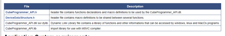

2023-09-29 3:50 AM - edited 2023-09-29 4:24 AM
Hello.
I'm currently have the same objective : I tried to build the api example under Linux.
But it their lib is only available for windows : ./lib/x64/CubeProgrammer_API.lib
That's an issue for me. Also doesn't make sense when downloading the linux package, does it ?
Regarding to STM32CubeProgrammer API package it should be available for windows, linux ans MACOS.
I wanted this to test the CAN flash capability, option not available with the STMCube Programmer. It seems they rely on the STLInk V3 to bridge this interface.
EDIT : I found the shared library in the installation folder, beside the API folder : /opt/st/STM32CubeProgrammer/lib/libCubeProgrammer_API.so
Just by changing the library search PATH in the Qt Pro file, and fix some issue in the code (missing cstddef include) I could have the example to build.
the embbeded documentation (chm) give full instructtions under "Application System Requirements". You should read it to get ready to developp with this library.
