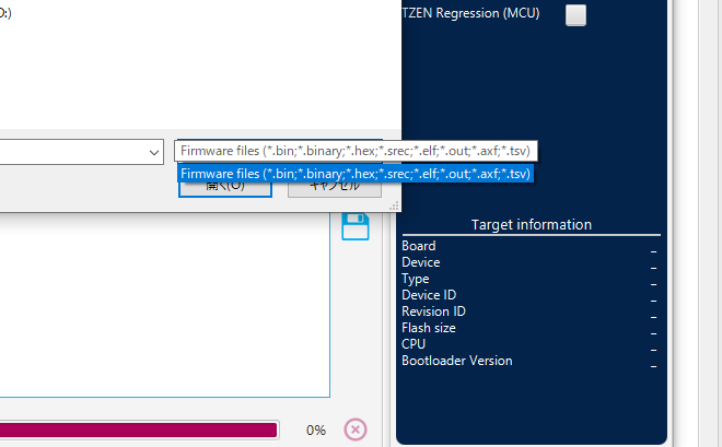

The CubeProgrammer User's Manual states that the following file formats are supported:
[ bin, binary, hex, srec, elf, out,axf ]
Also, I was able to confirm the same with Cube Programmer.
