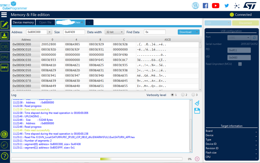

i tried to device memory read in cubeprogrammer, it worked.
i checked this in iar workbench that function MEM_If_Read_FS called
but, when i tried fw download using cubeprogrammer, only the progress bar moved from side to side, the cubeprogrammer did nothing. also, MEM_If_Erase_FS, MEM_If_Write_FS not called.
0693W00000D2ES5QAN.png -> it's stuck in this state.
I want to debug, but I don't know where to look because two functions don't worked.
Why did this problem happen??

1 REPLY 1
JPark.20
Associate II
Interrupt priority was set higher usb than systick. So, the tick did not increase, and remained in the hal_delay function. I was thinking that the function was not called. I hope no one makes the same mistake as me!
