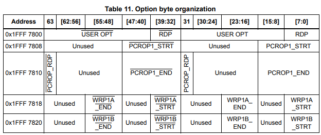

This is an STM32L422RB, and the reference manual says:
USER_OPT: 0xFFEF F8AA
PCROP start: 0xFFFF FFFF
PCROP end: 0xFFFF 0000
WRP A: 0xFF00 FFFF
WRP B: 0xFF00 FFFF
reading back the device memory after programming these values, all is well apart from both WRP fields, which read back as 0x0000FFFF, and thus verification fails

The option byte at 0x1FFF781B is unused, according to RM0394.
Maybe, program the same value as it reads out (FF or 00).
Same in the bits 63:32 - program the same value in the "unused" bits as they read out.
