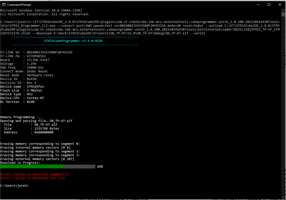

Let us try to conclude whether the problem exist in CubeProg stand-alone also or if there is an issue in the interface between CubeIDE / CubeProg.
Reading your log-file we can see that CubeProg is invoked using the following command line arguments:
C:\ST\STM32CubeIDE_1.8.0\STM32CubeIDE\plugins\com.st.stm32cube.ide.mcu.externaltools.cubeprogrammer.win32_2.0.100.202110141430\tools\bin\STM32_Programmer_CLI.exe --connect port=SWD speed=fast sn=002400235553500F20393256 mode=UR reset=hwRst --extload C:\ST\STM32CubeIDE_1.8.0\STM32CubeIDE\plugins\com.st.stm32cube.ide.mcu.externaltools.cubeprogrammer.win32_2.0.100.202110141430\tools\bin\ExternalLoader\MX25L12833FM2I_TP-H7_STM32H753IIT6.stldr --download c:\path\to\project.elf –verifyc:\path\to\project.elf to be substituted with your path in the project...
Does that work? If so, then we have to analyze in the IDE-team.
If not, then the issue is probably in CubeProg it self...
If it did not work, could you also please try the CubeProg GUI version to perform the same operation?
You could also try to perform a mass erase on the flash, sometimes that helps...
Let us know your findings.
2021-11-30 5:09 AM
Hey @mattias norlander , I tried to run this command and got the same result.
In GUI version of STM32CubeProg 2.9 I also can't flash my program to board. Mass erase is also not helping. Check CubeProg GUI version log file in attachment.
But I noticed I can normally mass erase/sector erase/read and write data to external flash.
So there must be a problem with new STM32CubeProgrammer.
