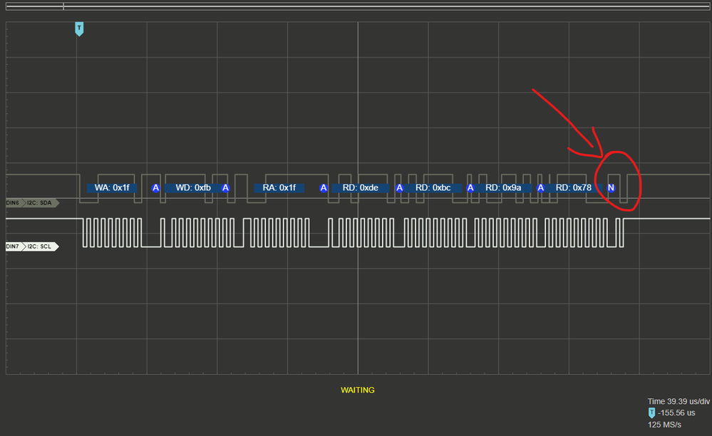

Here is the response when the master requests a buffer: You can see the NACK at the end right after the slave finishes sending the last byte

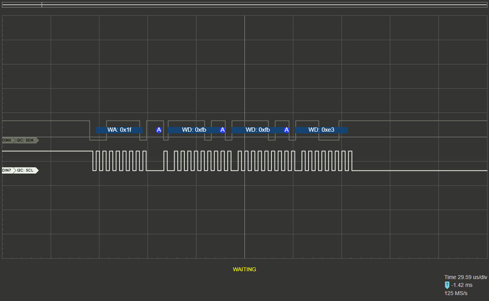

0693W00000UobFmQAJ.pngfor a master Write/Slave RCV operation: it goes wrong after writing the 2nd byte of the buffer. Why Am I having this? I'd scratched my head for months on this at this point

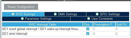

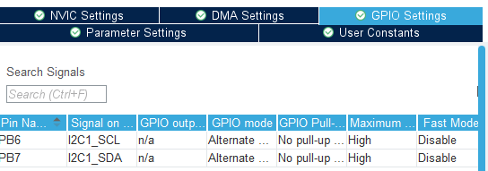

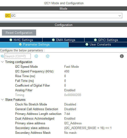

And here is cubeMX config for the I2C slave
0693W00000UobGBQAZ.png0693W00000UobGLQAZ.png0693W00000UobGQQAZ.pngAppreciate any insight you guys could have. Thank you!
