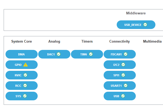

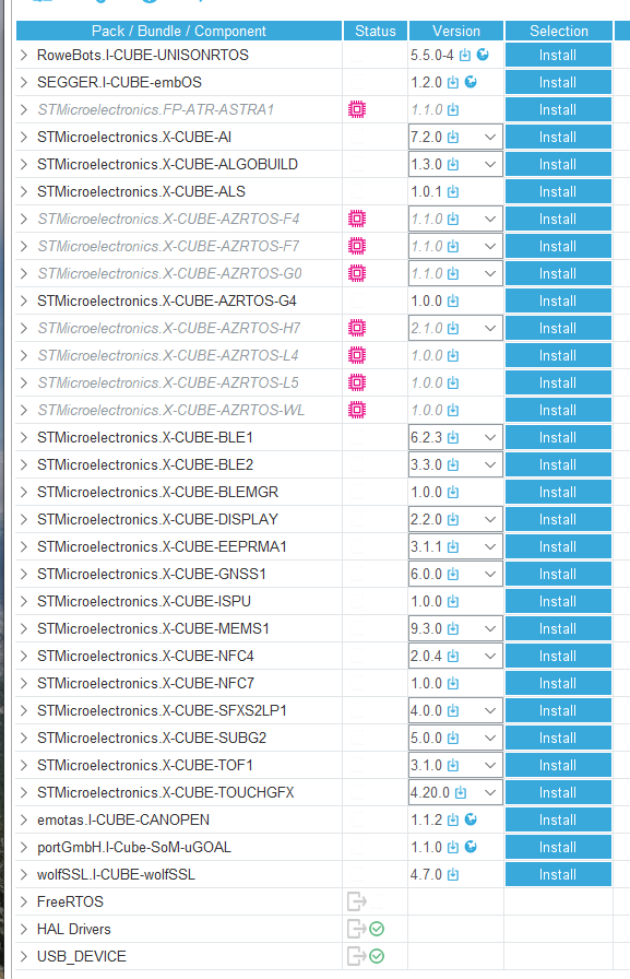

The CubeMX software packs I use:Selected features:
