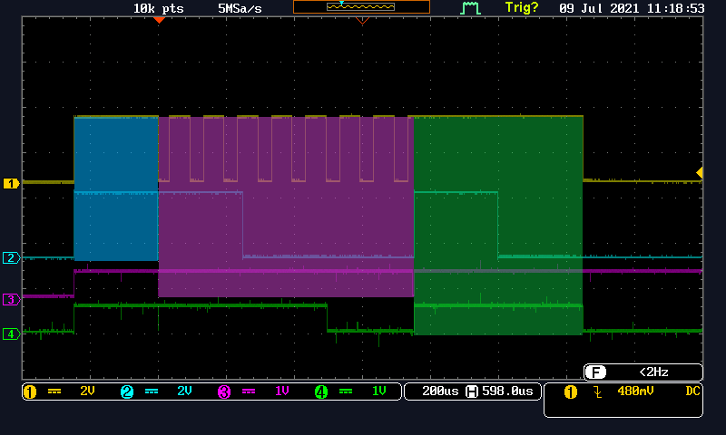

(Image Below) Correct first pulse width that only occur after program/hardware reset

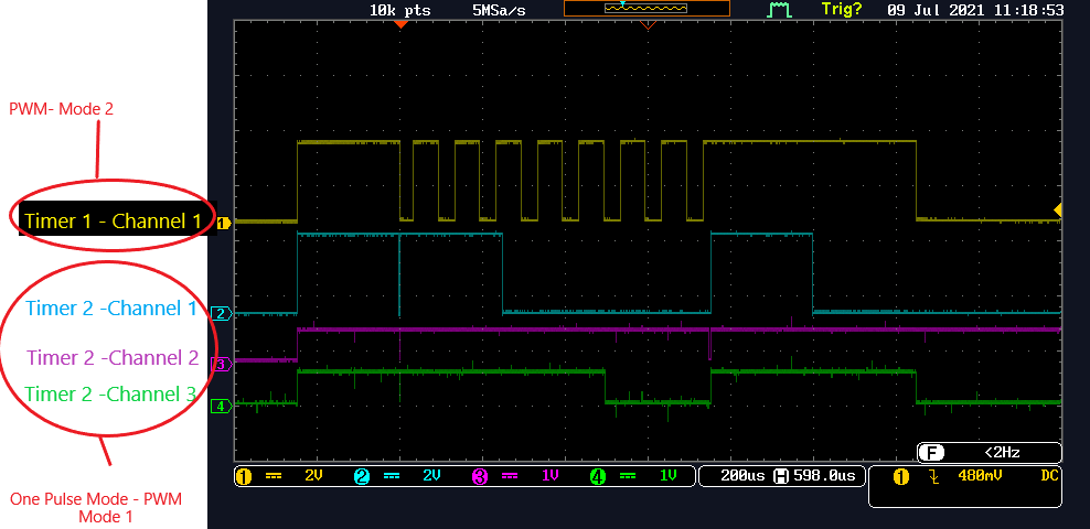

(Image Below) Using different timer 2 channel to adjust PWM 1's duty cycle
(Image Below) Pulse Width of each Channel in Timer 2

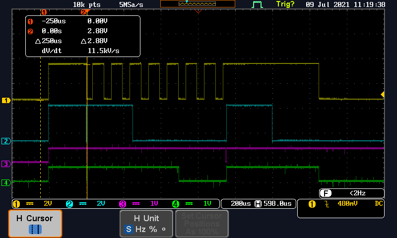

(Image Below) Cursor measurement of the correct 250us that only occur after program/hardware reset

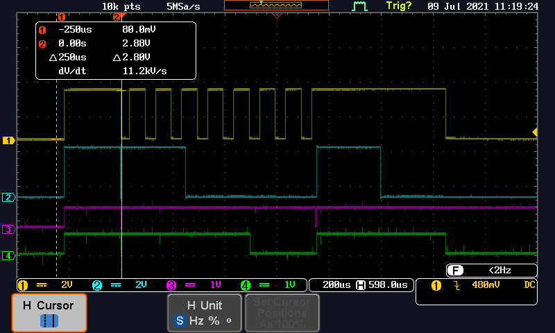

(Image Below) Wrong pulse width 1 (Timer 2 channel 1 pulse width no longer 250us)on the next button press
(Image Below) Wrong pulse width 2(Timer 2 channel 1 pulse width no longer 250us)on the next button press
(Image Below) Wrong pulse width 3(Timer 2 channel 1 pulse width no longer 250us)on the next button press

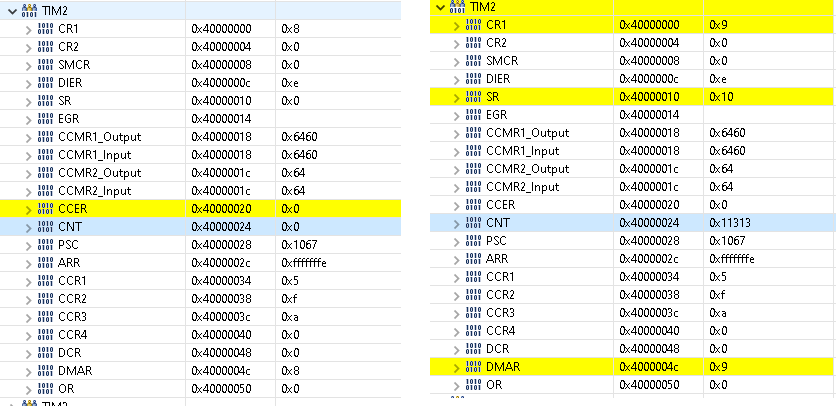

I placed a breakpoint in the button interrupt and read the registers of timer 2, I compare the register "when the board was just reset and the button is first pressed", and "the second time button is pressed". I then manually set the registers to identical as the first time, and the pulse width 250us is produced correctly again.
void HAL_GPIO_EXTI_Callback(uint16_t GPIO_Pin)
if(stateMachine_nextState == 0) {
stateMachine_finishedState = 0;
stateMachine_nextState = 1;
__HAL_TIM_SET_COUNTER(&htim2, 0); //breakpoint
TIM_CCxChannelCmd(htim2.Instance, TIM_CHANNEL_1, TIM_CCx_ENABLE);
TIM_CCxChannelCmd(htim2.Instance, TIM_CHANNEL_2, TIM_CCx_ENABLE);
TIM_CCxChannelCmd(htim2.Instance, TIM_CHANNEL_3, TIM_CCx_ENABLE);(Image below) Left is first button press, Right is second button press
Update2 : manually setting the registers to produce the correct pulse width only worked some times, so it seems the cause is from something else
