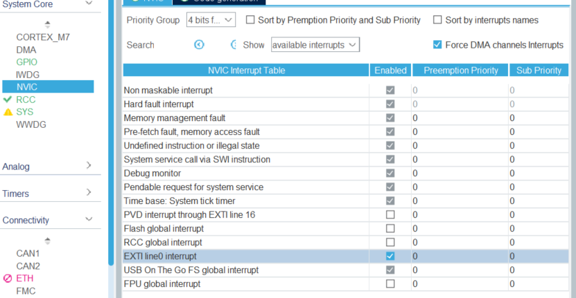

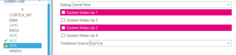

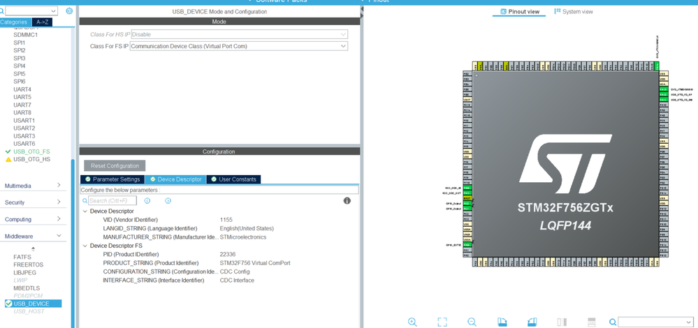

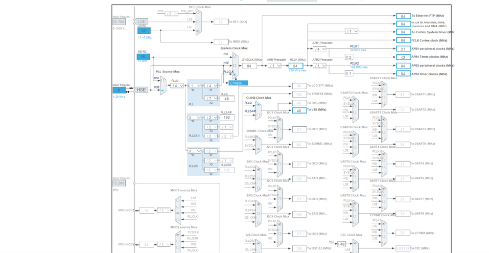

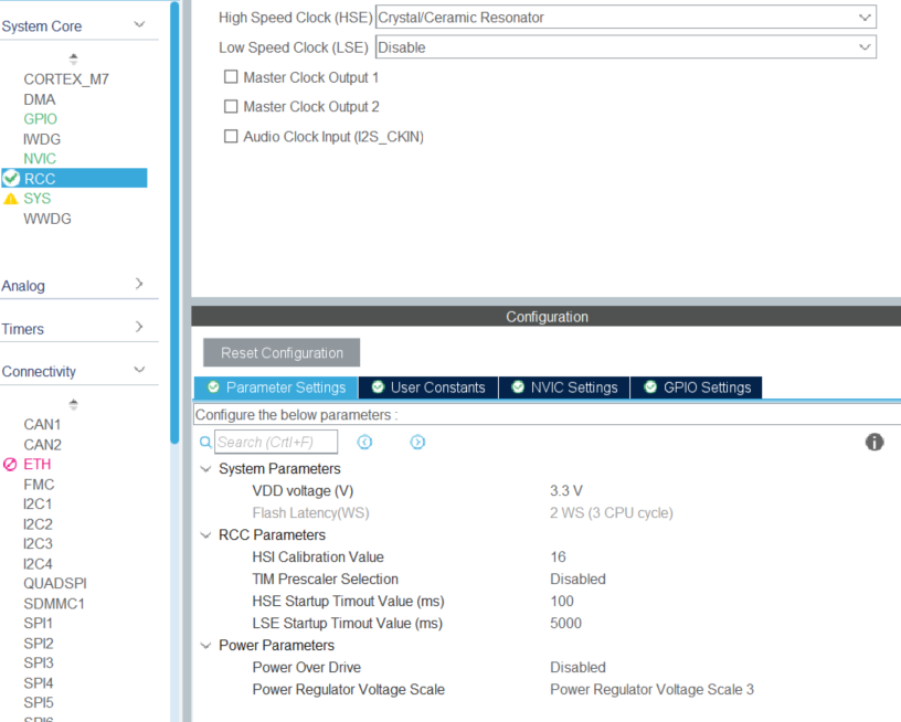

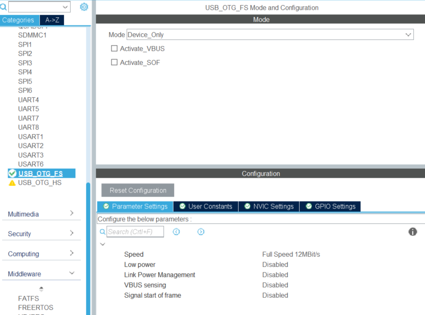

0693W00000FAlpfQAD.png0693W00000FAlpuQAD.png0693W00000FAlqTQAT.png0693W00000FAlsUQAT.png0693W00000FAlrlQAD.png0693W00000FAlrMQAT.pngI cannot communicate with my computer. I detect the port but in debug mode, I see that the OTG_FS_IRQHandler interrupt is triggered regulary when I send data on my computer.
I did the same thing with my dicsovery card F411, it works. But with nucleo F756, it doesn't work. I'll give you all the parameter I set in picture linked.
