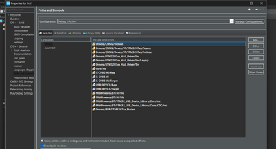

So it's telling you that it can't find the file stm32h7xx.h
Therefore you need to check two things:

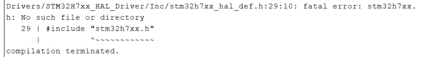

BTW: it's better to post the error messages as text - rather than an image:

Drivers/STM32H7xx_HAL_Driver/Inc/stm32h7xx_hal_def.h:29:10: fatal error: stm32h7xx.h: No such file or directory
29 | #include "stm32h7xx.h"
compilation terminated.

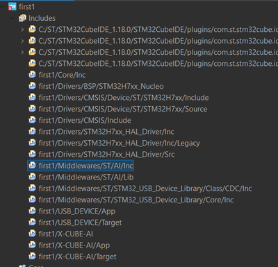

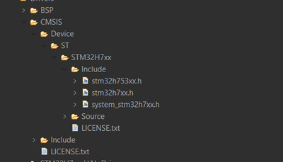

You haven't answered @Andrew Neil 's questions - does that file exist? It normally lives in the Drivers/CMSIS/Device/ST/STM32H7xx/Include directory. It the file IS there, can you open it with an editor? That would check for strange file access attributes.

2025-03-13 8:21 AM
yes sir it is there
2025-03-13 2:03 PM
But did you try to open it with some editor like the IDE or Notepad (looks like you are on a Windows PC)? Like I said, maybe there is a permissions issue (somehow) with that file.
2025-03-13 8:37 PM
Yes sir... i did that also.... it is opened in text editor...
