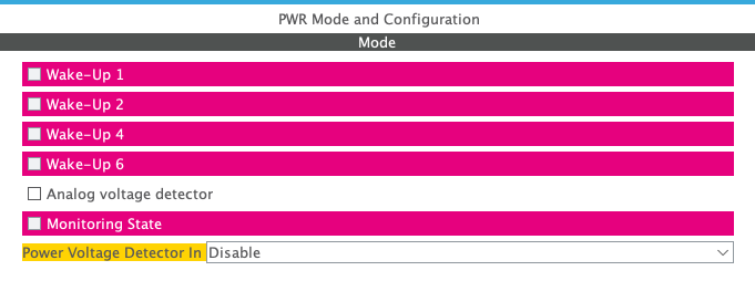

Right now I am having to manually alter the code after each generate
I would expect it here
But all I see is
What am I missing?

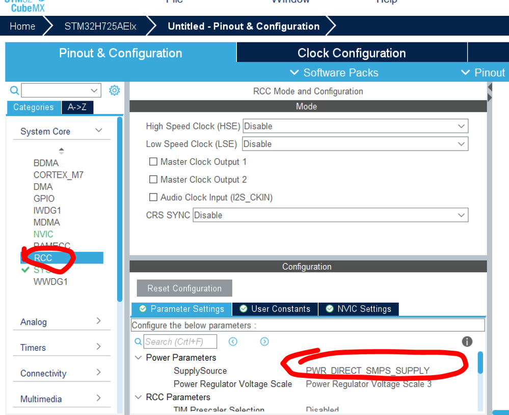

2021-10-23 10:36 AM
The power supply source setting is under "System Core" in the RCC tab.
2021-10-23 10:36 AM
