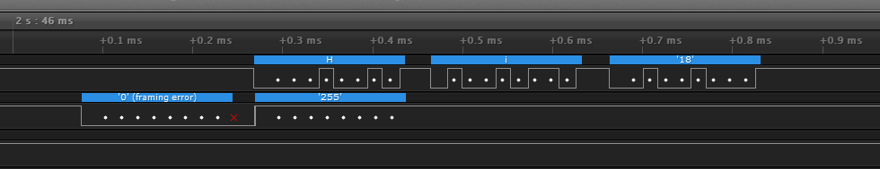

While USART (receive from PC and transfer of gained information back, pic. 1) perfectly works on low baud rates like 9600, use of high baud rates leads to obscure results (bad receive and OK transmit, pic. 2)

OK and now show the waveforms on the STM32 UART pins observed by the logic analyzer.

Sending "6" to STM, receiving back "Hi" and interpreted 6

I don't understand what do you display here. Why don't you do the same "echo" test as above, so that we can see both waveforms on Rx and on Tx pins and compare them.
