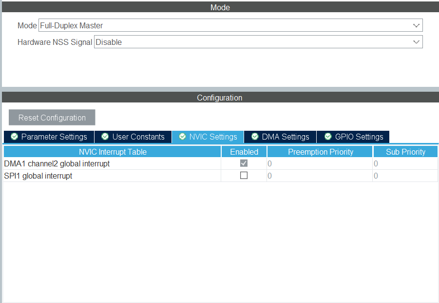

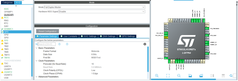

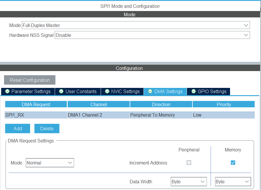

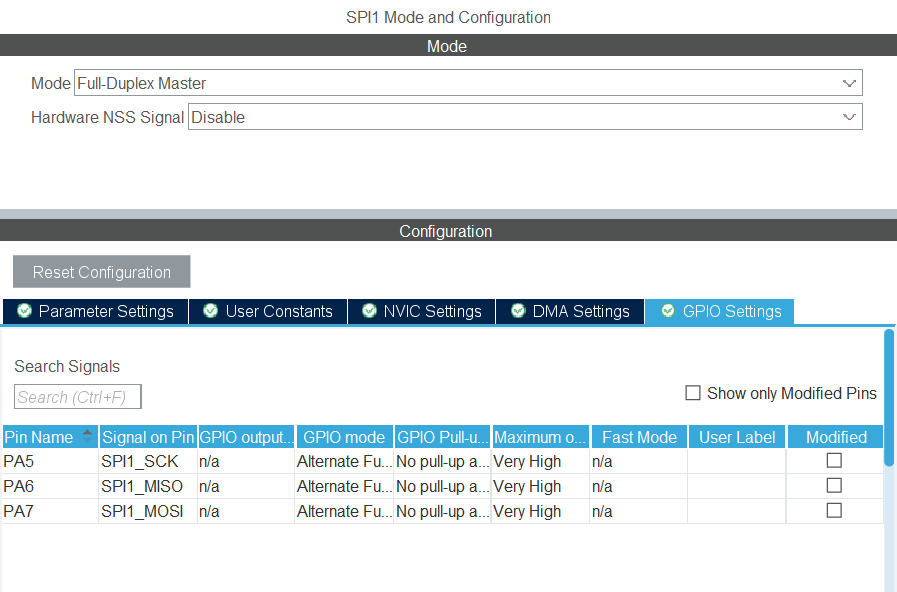

Also we have tried DMA with SDIO using FATFS file system and we are not successful.

When DMA is used, the MX_DMA_Init shall always be called before any other HAL_***_Init (where *** is any peripheral with a HW dependency on DMA init code).
Please refer to this post for more details : MX_DMA_Init order in the main.c file generated by STM32CubeMX, How to fix?
