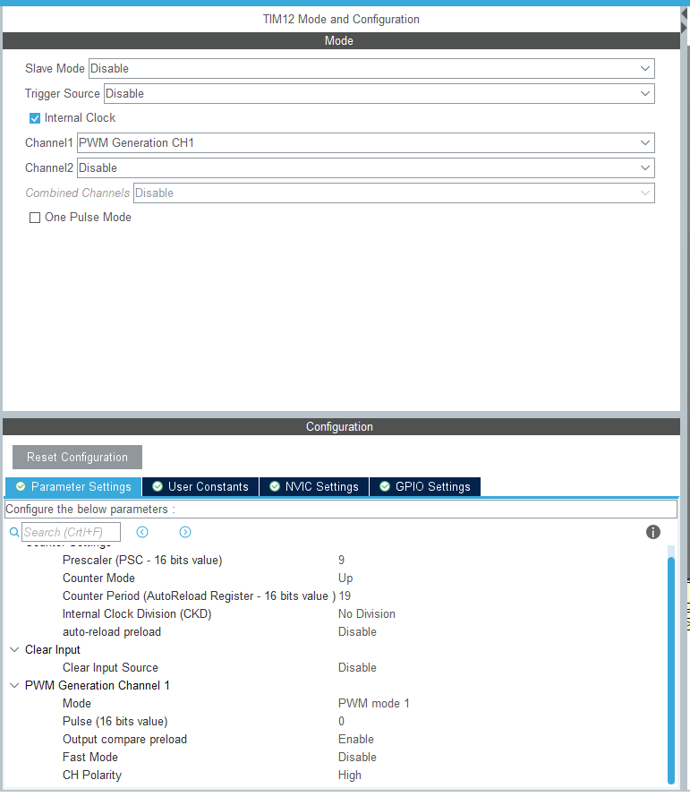

2021-07-25 8:30 AM
In cubemx, the config of Tim12 TGRO is missing.
Where in tim1, i can config it under Trigger Out Parameter. This feature is required by DMA request generator.
I tried manually add some code to init this, but none of them work.

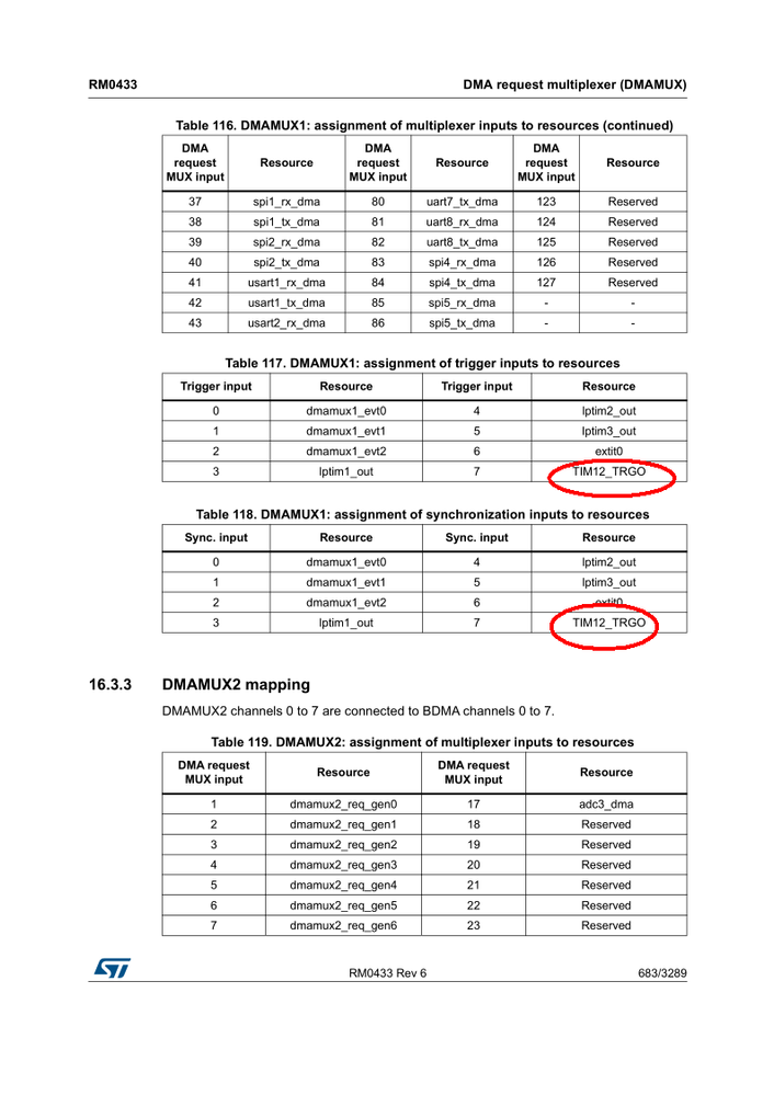

2021-07-25 12:57 PM
Which STM32?
> Only master timers have this capability.
No. TRGO from various timers can trigger not only other timers, but in newer STM32 also DMAMUX/DMA, and ADC.

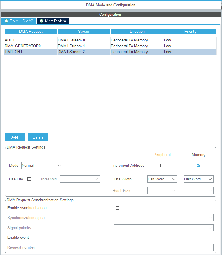

I would wonder if i could use something like this.
I configured TM1_CH1 as DMA request. The TM1_CH1 output a 1MHz PWM wave.
HAL_DMA_Start(&hdma_tim1_ch1,&GPIOB->IDR,test,100);As far as i understand, DMA is like a interupt, so the request is not concerned with the srcAddr. But this failed to run.
Am i wrong? Hoping to hear from you!
