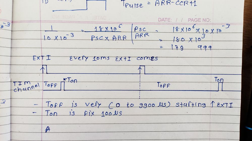

2020-03-21 4:44 AM
i want to generate above signal with variable Toff and Ton fix.
i generate code but i don't get my desired out put signal.

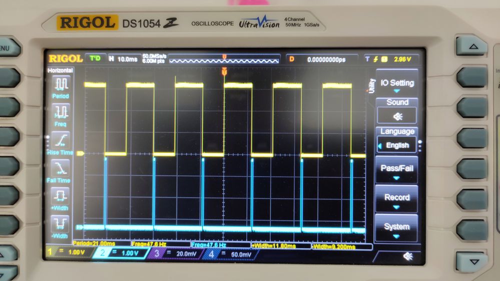

HAL_TIM_OnePulse_Start(&htim1,TIM_CHANNEL_1);
Then i got out put signal like below(yellow).
so how can i generate signal as drawn in 1st image?
what is change in my code.
