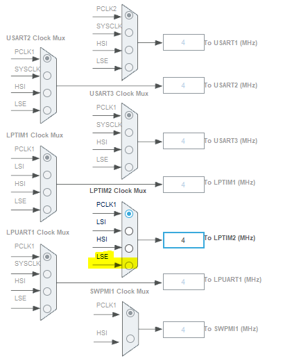

In the datasheet page 25, it is indicated that in mode stop 2 LPTIM2 is frozen. But in STM32CubeMx Version 5.2.0 we can see that LPTIM2 Clock mux can choose LSE so the timer is not frozen. Is there an error in the datasheet?

Hi @Community member
I redid the same scenario, you can't choose LSE in the LPTIM2 Clock .

2019-05-15 4:23 AM
Nesrine
Have you enabled the LSE in RCC settings? I redid the scenario too, and I can choose LSE as LPTIM2 Clock.
Mich
I think there is no contradiction, you can clock LPTIM2 from LSE, but LPTIM2 isn't active in stop mode 2, even if LSE is active.
